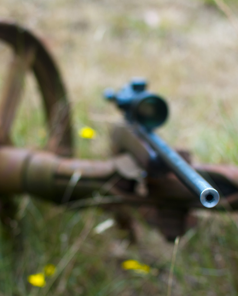

Post by Gwion » 18 Sep 2016, 11:53 am

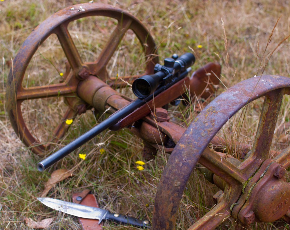

Thought i'd share some pics of my old Sporti 62A .22lr that i have done some fixing on over the last few years.
When i first borrowed the rifle off a friend it was suffering somewhat from some very crude modifuckations. Someone had previously taken a hacksaw and lopped off the end of the barrel, including the front sight. I guess that mad the rear sight useless or it got in the way of a scope so the very roughly bashed that off as well. Then, they decided that the crew at Sportco didn't know what they were doing and that the rifle needed an rear action screw instead of just the single barrel lug screw that originally held the steel and timber together. In the process of drilling and taping the rear of the rear (expanding the hole that originally took one of the trigger group screws), they completely screwed up the timber in that area of the stock.
First thing i did was to bed the rifle, which meant i had to inlet a block of blackwood into the stock to rebuild some solid timber around the rear of the trigger group. I also installed a carbon fiber pillar there. Whilst doing this, the crappy screw the farm yard gunsmith had used gave out and i had to re-tap the hole and fit another screw, choosing a high tensile job this time 'round. I got it shooting quite nicely, even with the hacksawed off muzzle/crown, so i refinished the stock with my own little home made potion and sent the barreled action off to a gunsmith near Hobart to be re crowned; he also fixed the trigger which was sort of floating at the rear due to farm yard gunsmithing or 'modifuckations' (Rolf Hey, highly recommend him for quick turn around, good pricing and top notch work!).
Here is what it looked like after i had finished repairing it...
Sporti with scope mounted...
Sportco 62A 22LR 01.jpg (372.16 KiB) Viewed 11038 times
Rolf Hey crown job...
Sportco 62A 22LR 04.jpg (135.83 KiB) Viewed 11038 times

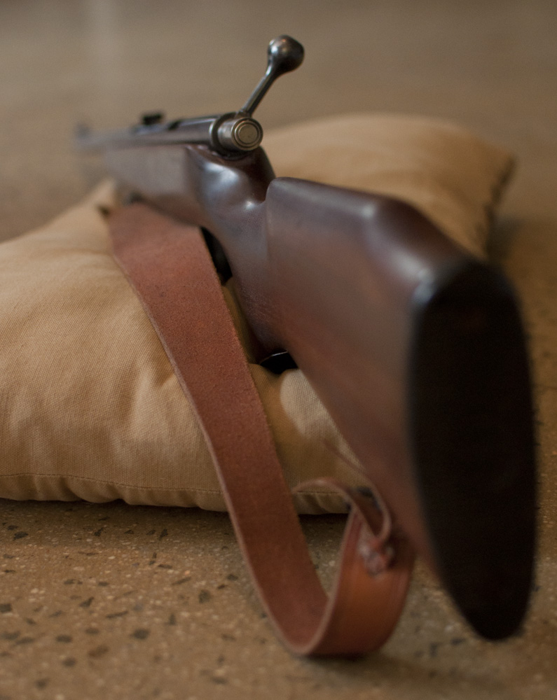

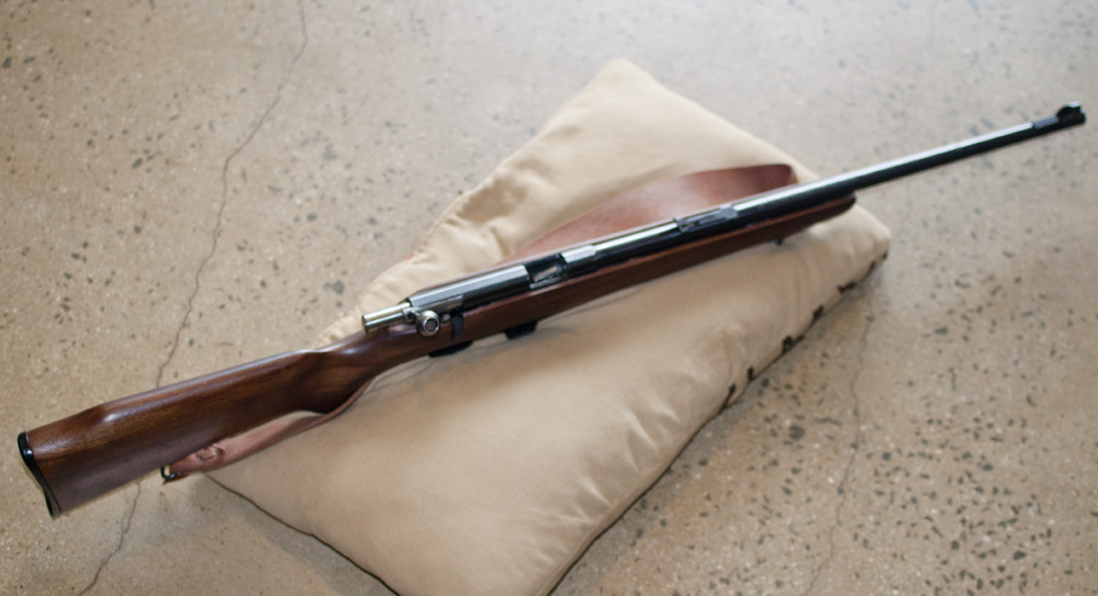

Well. As this is technically my wife's rifle and she can never get comfortable behind a scope, i decided that the rifle would be best with some iron sights so she can shoot it more comfortably; she'll never be taking longer shots than about 30m. Besides, i wanted a rifle with open sights to muck around with as well as take those bloody vegie thieves inside 10m, which a scope is just crap for.
Off it went back to Rolf..... he did the work that day with some sights he had lying around. Also re-crowned it again due to a unfortunate incident with a concrete floor. Photos below.
One QUESTION for you all. I am only familiar with open sights that have rear windage and elevation adjustment. This old leaf system has me a bit perplexed. I see how the elevation is adjusted but what do i do to correct windage for the rifle's preferred ammo???
Also, i'm interested to get an idea of year of production. I've looked up serial numbers and such but info on even a rough period of production is hard to come by. Anyone got some idea???
Iron sights fitted... now it looks somewhat more like it originally would have.
Sportco 01.jpg (155.76 KiB) Viewed 11038 times

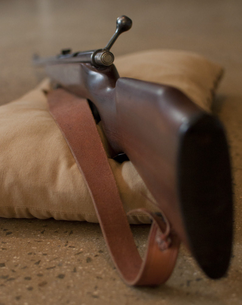

The old girl... nice and simple.
Spotco 03.jpg (195.88 KiB) Viewed 11038 times

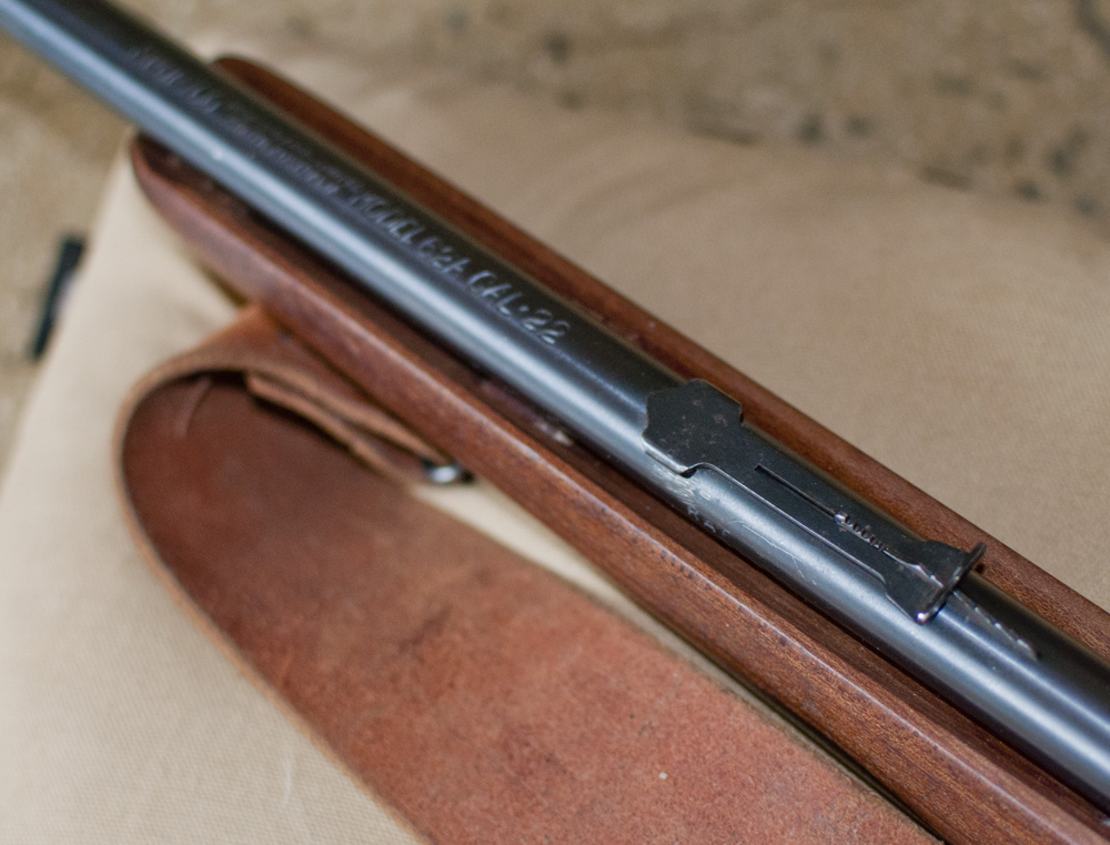

Leaf sights... how do i adjust for windage???
Spotco 04.jpg (233.05 KiB) Viewed 11038 times

Post by Heckler303 » 18 Sep 2016, 12:47 pm
Damn it sucks when someone has to bubbarize something good on it's own. I've got 2 No.4 lee enfields and an M1917 that have really had a hard time in the hands of bubba + his blunt secondhand tools. Thankfully all have been saved and work brilliantly.
What kind of ammo does it like/what group sizes on average?

Nice job on the old Sportco, Gwion, to adjust windage you will need to tap the rear sight either left or right to get to your zero, I take that it is in a dovetail on the barrel, don't hit it too hard as it won't need to move too far

Post by Gwion » 18 Sep 2016, 12:57 pm
With the scope it was shooting Win PP42max very well. Around 0.75" and less @ 50m. Open sights will change things a bit and i'll have to tune the action screws back to where they were. I'll have to look up old test targets for those specs.

Strikey wrote:Nice job on the old Sportco, Gwion, to adjust windage you will need to tap the rear sight either left or right to get to your zero, I take that it is in a dovetail on the barrel, don't hit it too hard as it won't need to move too far
Thanks again, mate. Will let you know how it goes.

That looks suspiciously like a lithgow mod 12 rear sight. but looks like the correct front sight.

Hey Dean.... My thoughts exactly. I just asked Rolf to fit whatever he had lying around that would work. If the rifle was in more original condition I might have made more effort to source the correct sights.

Sighted it in @ 25m(ish). Took a bit of doing because i started adjusting the wrong way to being with. With a bit more practice i should do alright with it.

The way I remembered for adjusting windage was to imagine the sights aimed directly at the target and the rifle moving. So if you are shooting to the right the rifle needs to move left. Hence the front sight goes right.
Or you move the sights towards the bullet hole relative to the target. Shooting right, drift it right.
Funny one of those simple things that can take a little bit to initially get your head around.

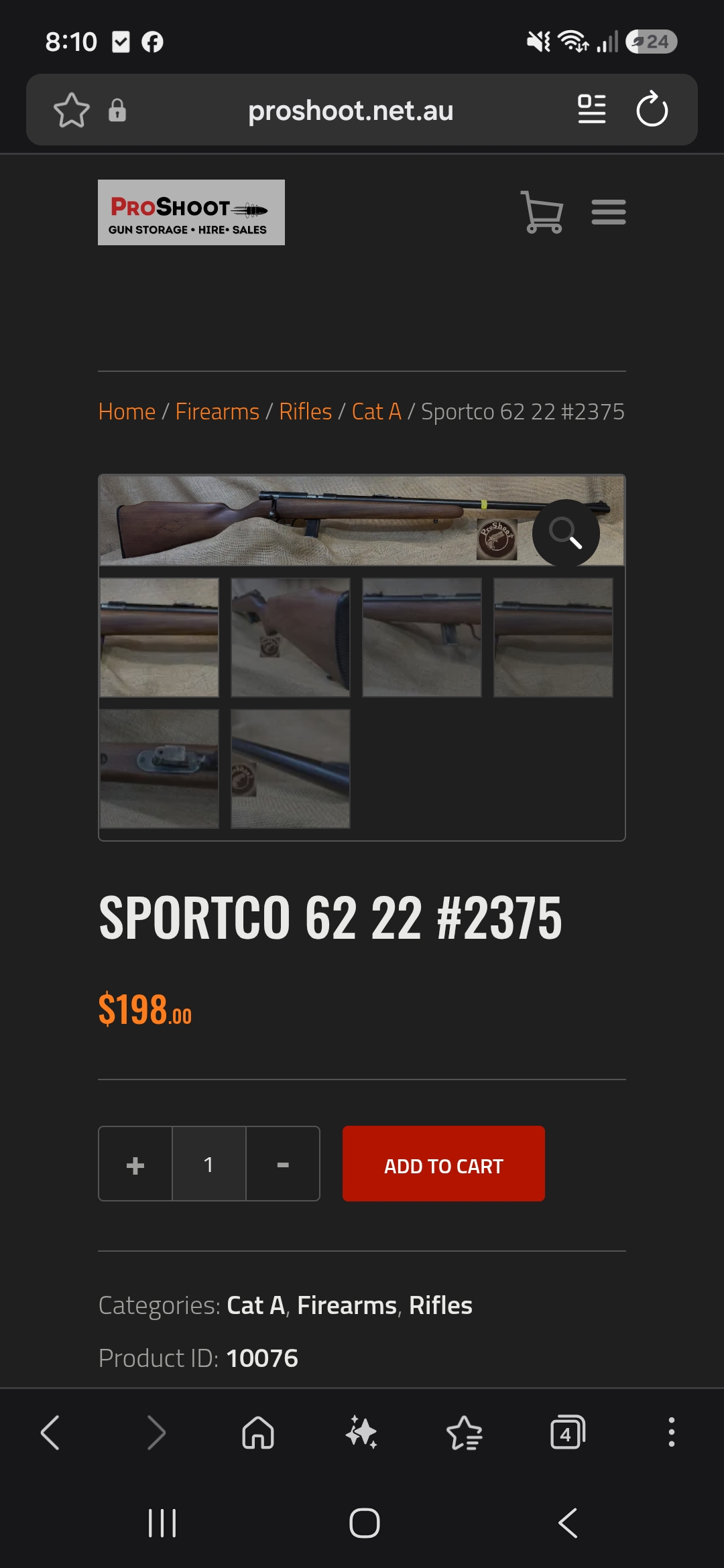

Post by Cape_Yorkee » 26 Sep 2026, 10:40 pm
Bigrich, I just picked up this old 62 a month or so back. Craved a nice little bolt action 22 and because I'm a fussy bugger I hung out for a while until something semi decent showed up. Of course there is plenty of old 22's around and dirt cheap but getting your hands on an old school one that still 'has it' is not so easy! Been away with work all month but taking it to the range on Thursday. Leaving it with iron sights for the time being. Action is slick and magazine seems to be in really good shape. Plan on buying another spare mag or two if possible.

Post by bigrich » 27 Sep 2026, 5:58 am
Cape_Yorkee wrote:Bigrich, I just picked up this old 62 a month or so back. Craved a nice little bolt action 22 and because I'm a fussy bugger I hung out for a while until something semi decent showed up. Of course there is plenty of old 22's around and dirt cheap but getting your hands on an old school one that still 'has it' is not so easy! Been away with work all month but taking it to the range on Thursday. Leaving it with iron sights for the time being. Action is slick and magazine seems to be in really good shape. Plan on buying another spare mag or two if possible.
good score mate . make sure you give a update after a range session :)
yeah proshoot is cheap on price , i've been meaning to get some spares for my savage 23C from him . finances ATM are holding me back from getting another rifle . i've had repairs to my fourby , rates, rego, new glasses and half dozen things draining my bank one after another :roll: it's all bloody albo's fault ;)

Post by Cape_Yorkee » 27 Sep 2026, 7:01 am
This is my 3rd firearm from proshoot and cannot fault any of them so far nor the service received.
In the hands the Sportco definitely feels very solid. They are well built like everything was back in the day.
