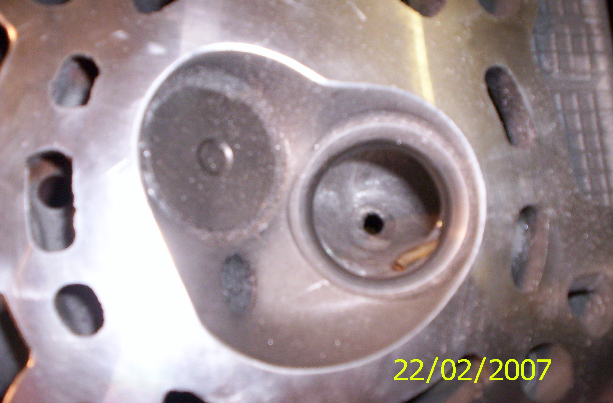

sungazer wrote:The ones such as the JB weld and Devcon with the small steel powders make them harder for the purpose of being able to machine them. Although I have taken a dremel like tool to them and they are very easy to work (soft as) anyway the fiberglass mats or woven have long fibers that will give although some flexibility (think canoes) they give greater breaking strength.
I use Devcon for shaping intake ports in cylinder heads, magic stuff.
February 20th 2007 052.jpg (587.14 KiB) Viewed 10943 times
