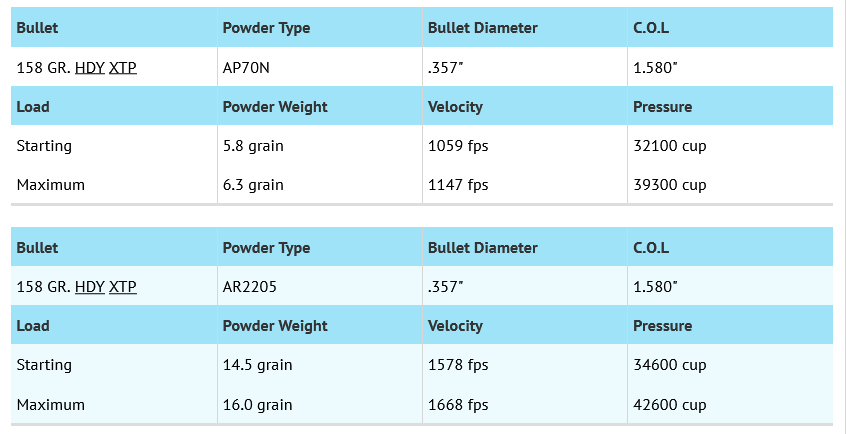

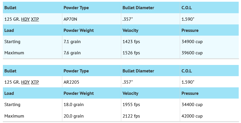

My current loading is Speer GDHP's. The 125g are listed as self defence. The 158g are noted for hunting.
Speer doesn’t list any velocity recommendations.
ADI data.
ADI web data
ADI web data

357 in a Rossi 1892 is all I use for them. I prefer 158gn bullets, and you can do a lot better than ADI velocities too. In fact I'd be suprised if any factory ammo with 158 gn bullets would chrono as low as the data above. The issue of course now for reloads, as hashed out on other threads is no dedicated pistol powders left in Australia. My choice for available ammo remaining would be the cheap 158 Geco flatpoint factory ammo. Havent tried it but its full powered and a flatpoint so assume it holds together okay.
