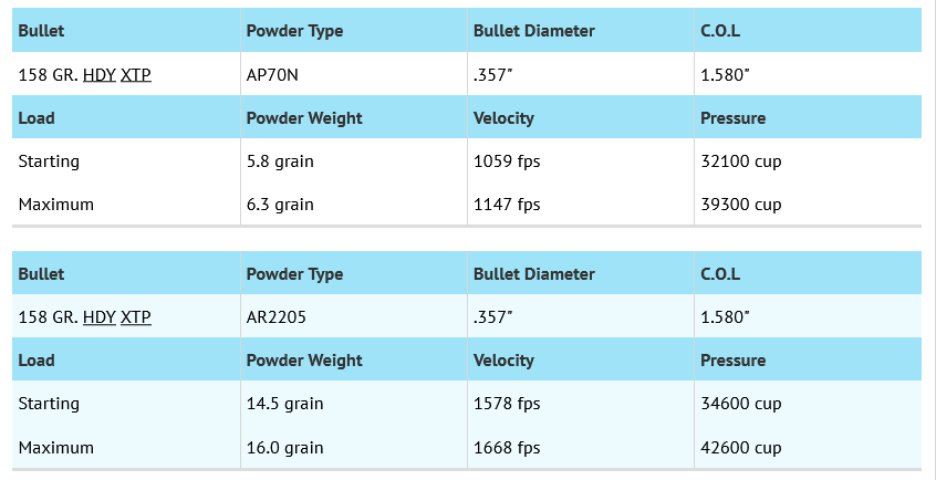

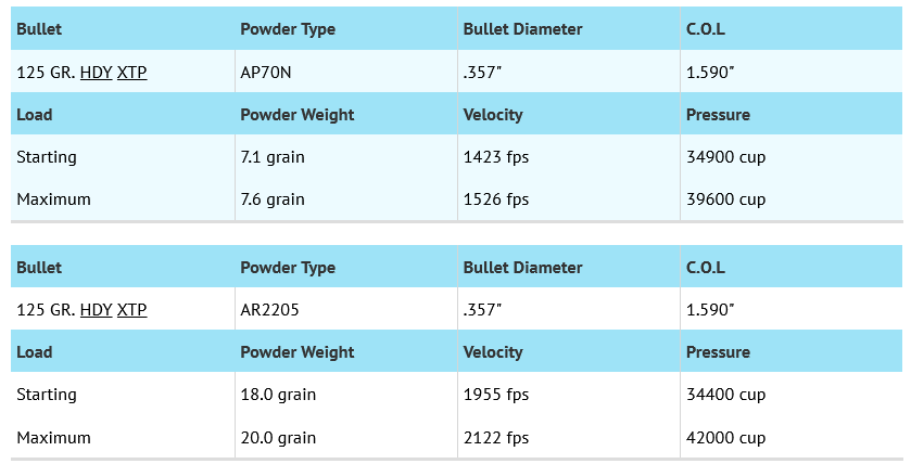

Post by Pendous » 20 Feb 2022, 8:05 am
As others above, yes the 357 Magnum it is an acceptable cartridge for pigs and other game for that matter.
I have used one with no problems on the receiving end.
I have a Rossi which is light weight and points well.
Trajectory is not your friend here but that's not the point of using 357 Magnum in a lever.
Commercial loads will primarily be self defence offerings but should do ok on game.
My current loading is Speer GDHP's. The 125g are listed as self defence. The 158g are noted for hunting.
Speer doesn’t list any velocity recommendations.
ADI data.
ADI web data
Screenshot 2022-02-20 at 08-26-23 Data - Rifle.png (29.79 KiB) Viewed 34172 times
ADI web data
Screenshot 2022-02-20 at 08-27-12 Data - Rifle.png (28.92 KiB) Viewed 34172 times

357 in a Rossi 1892 is all I use for them. I prefer 158gn bullets, and you can do a lot better than ADI velocities too. In fact I'd be suprised if any factory ammo with 158 gn bullets would chrono as low as the data above. The issue of course now for reloads, as hashed out on other threads is no dedicated pistol powders left in Australia. My choice for available ammo remaining would be the cheap 158 Geco flatpoint factory ammo. Havent tried it but its full powered and a flatpoint so assume it holds together okay.
