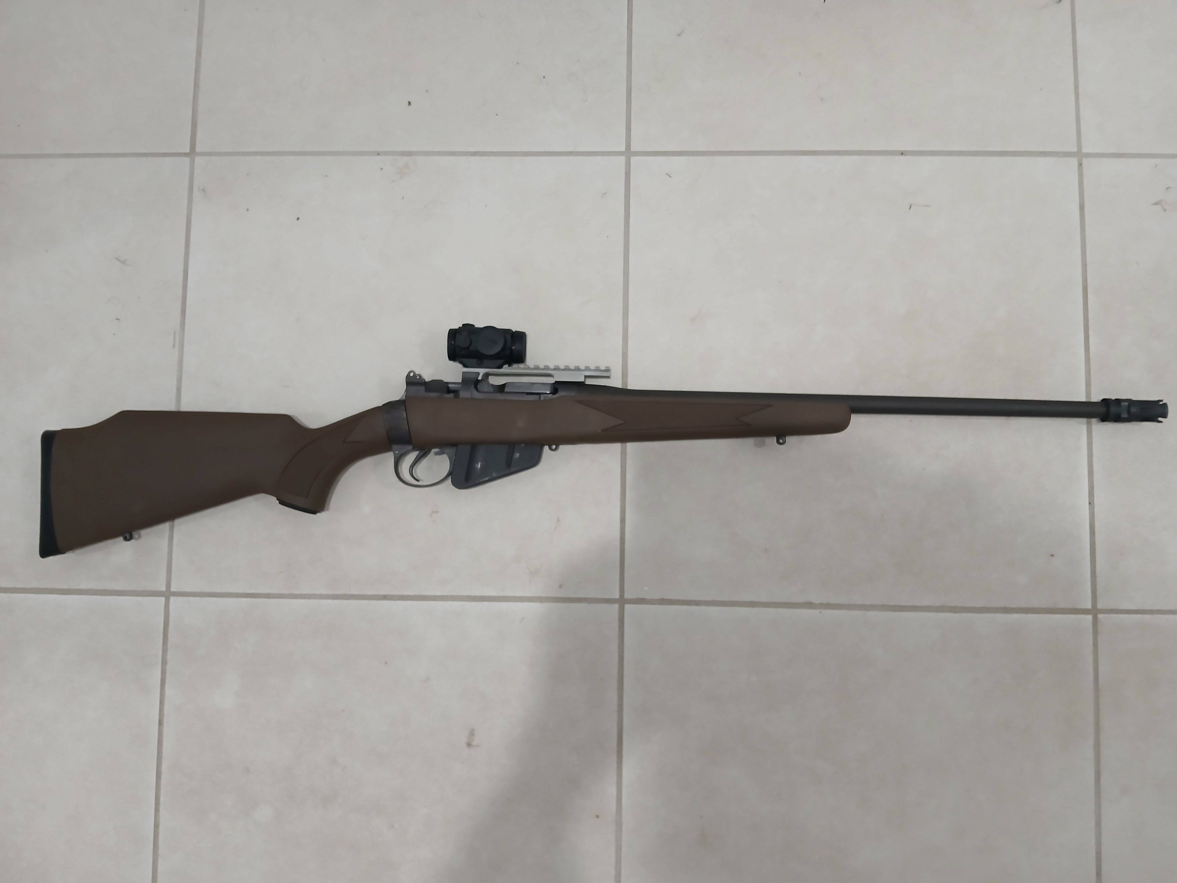

This is the flash suppressor I fitted to my sporterized No4 .303. I have no idea if it actually " suppresses " the flash as I have never fired it at night. I put it on the end of the barrel not for wank factor, but purely to protect the muzzle if I throw it into the ute muzzle first. What I have noticed is. After firing the rifle without it and then with it is it feels to stabilize muzzle lift considerably. This particular suppressor can be timed to any position you want. It comes in 5.56 and 7.62. I had my gunsmith check for clearance ( 7.62 ) for 303.
Stoney

Post by Stoney » 03 Jul 2025, 7:40 pm
womble wrote:Thanks Stoney.
One of the three I ordered is a bit similar to that, but it’s 223 and a retro slightly inverted duck bill design. It looks pretty heavy duty though.
I’m always on the lookout for a nice example of a sporterized No 4. They are a fun gun to shoot rapidly. But it’s hard to find a nice one and a bit of a lucky dip for a shooter.
This is a picture of the old girl. Goes good as. I will shorten the barrel by an inch or 2 I reckon. Just so it swings better.

Post by womble » 03 Jul 2025, 7:48 pm
Very tidy :thumbsup:
