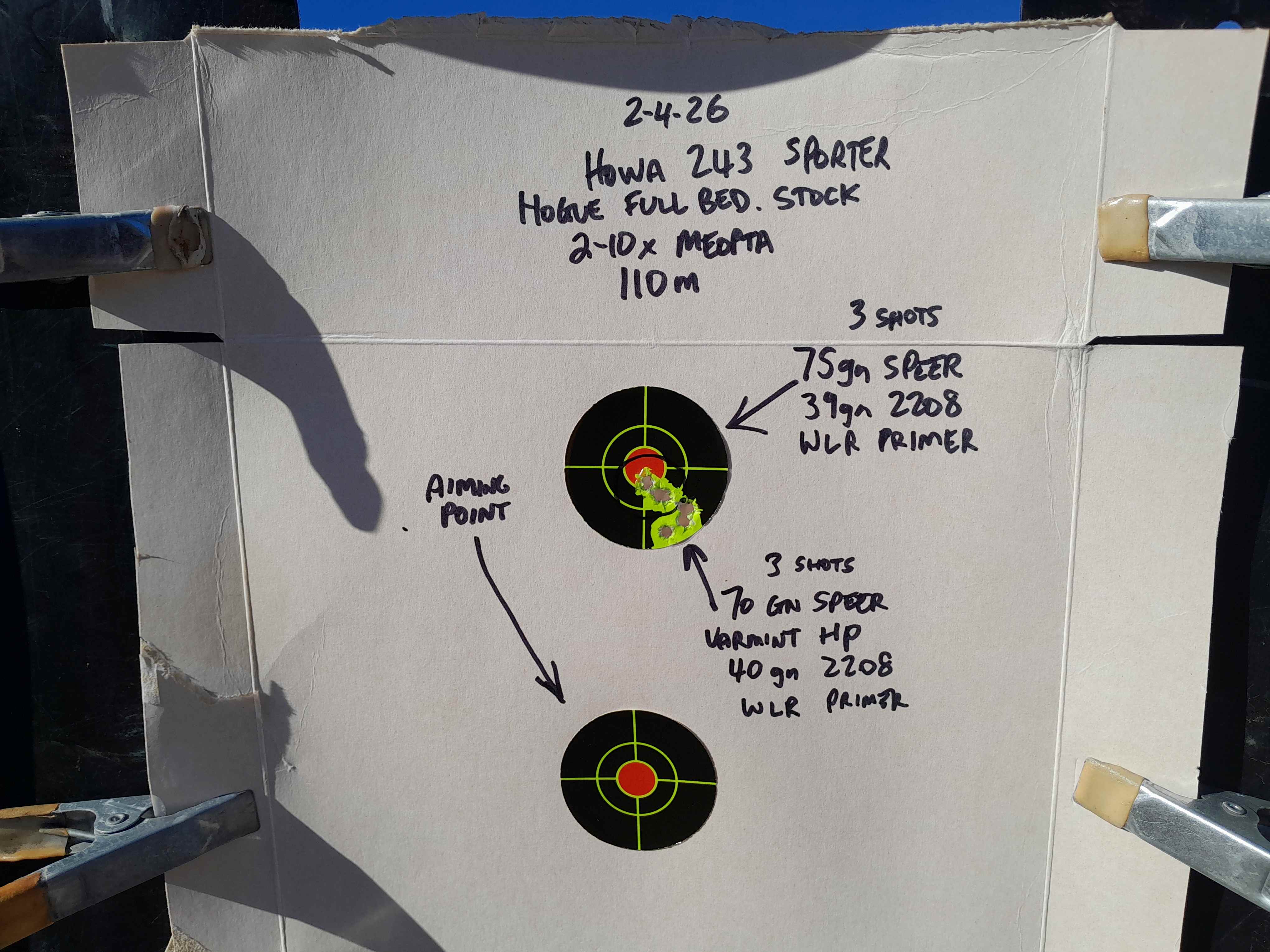

So for those interested, here's the results of 2208 powder, cheap PPU cases and nothing-fancy WLR primers.
I got a few 100 packets of PPU cases from Cleavers for $29.90/100.
Picture has the info. Velocities in the 3350 range, not that quick but I find 2209 is a quicker-speed powder in the 243. Making these things go too fast for dogs is most likely not a problem.
These two groups were shot at twilight, 6.15pm and through this unreal scope you'd think it was lunchtime.

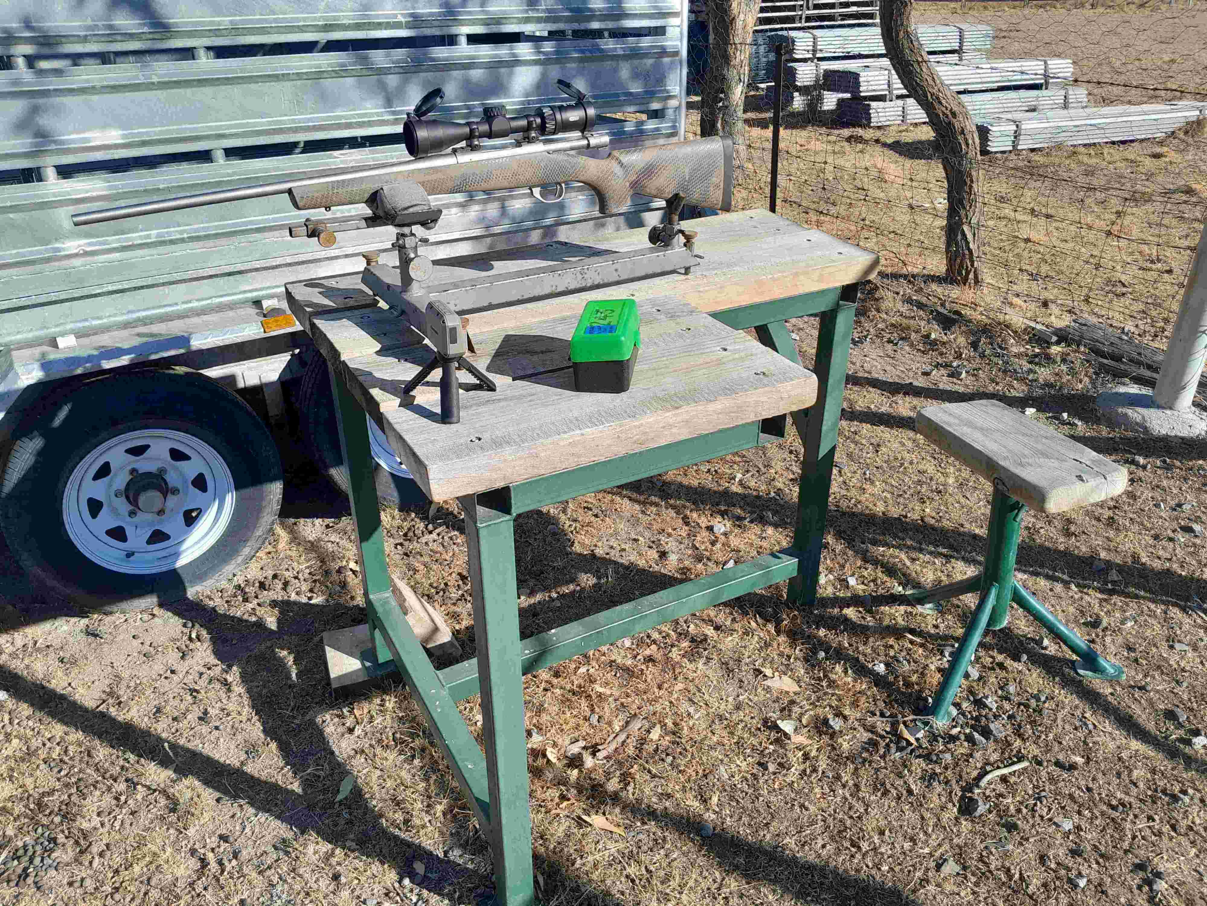

Home-made bench rest, made 25 years ago before those cheap spongy Lead Sleds were even invented. Made them for all my mates.
Home-made benchrest, from a throw-away box section frame that was for transporting cattle panels.
Top of warping pine sleepers, doesn't matter cost the benchrest has 3 feet.

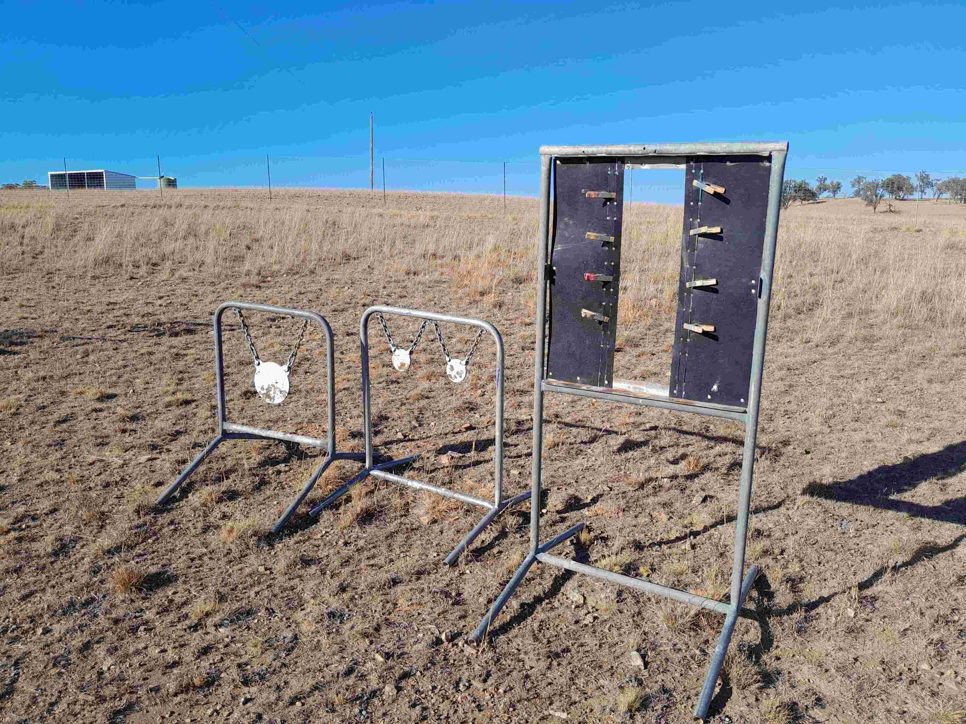

Everything homemade, target frames, targets from Weet-bix boxes inside-out, with cheap Ebay Shoot-N-See sticker spots to aim at.
All made from scrap, except the AR500 gongs, which I got off Ebay for half the gunshops price, posted to the big farm letterbox.

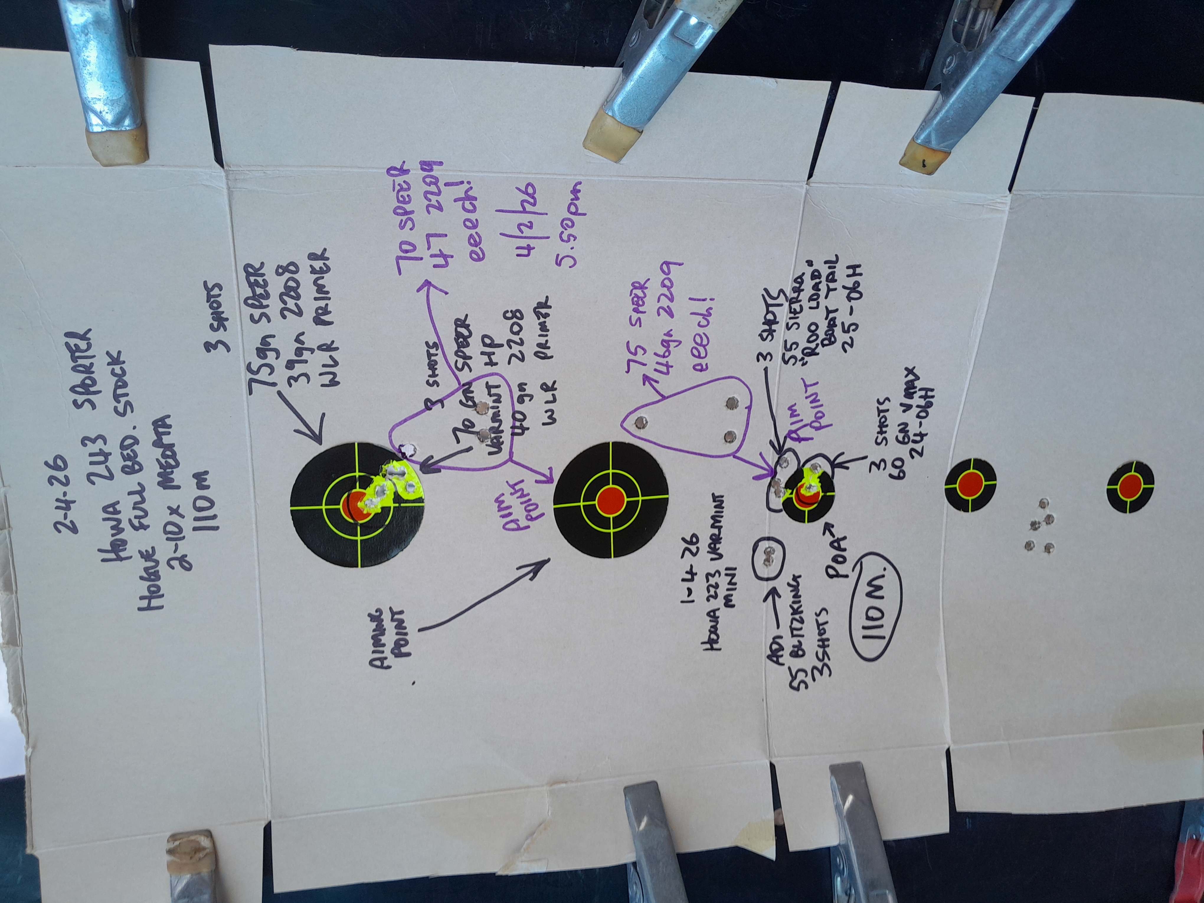

So here's the results from yesterday evenings 2209 trial. As you can see, not everything comes out great.
Screaming speeds, low 3500fps for the 70gn and high 3500fps for 75gn Speers.
Loads were straight out of the ADI and Uncle Nick's book, both are identical. One of them has copied the other I suspect.
But screaming speeds are useless if the ammo sprays, and this powder did yet again.
I cannot find a load, or projectile, or seating depth, that works with 2209 in this particular rifle. I had hoped the 2208 results woukld carry over to 2209, but it is definitely not going to work. Maybe if I screw around with varying powder weights to find the "node", but if it's that fussy, I've no time for that wasting resources and time when 2208 works so well. Proof yet again, that if you do or don't reload, many firearms are fussy and you can stumble on a great load or brand, or they will make you work for it.
Results in the purple pen, on the same target so you can see the difference. Please ignore the previous 223 testing.

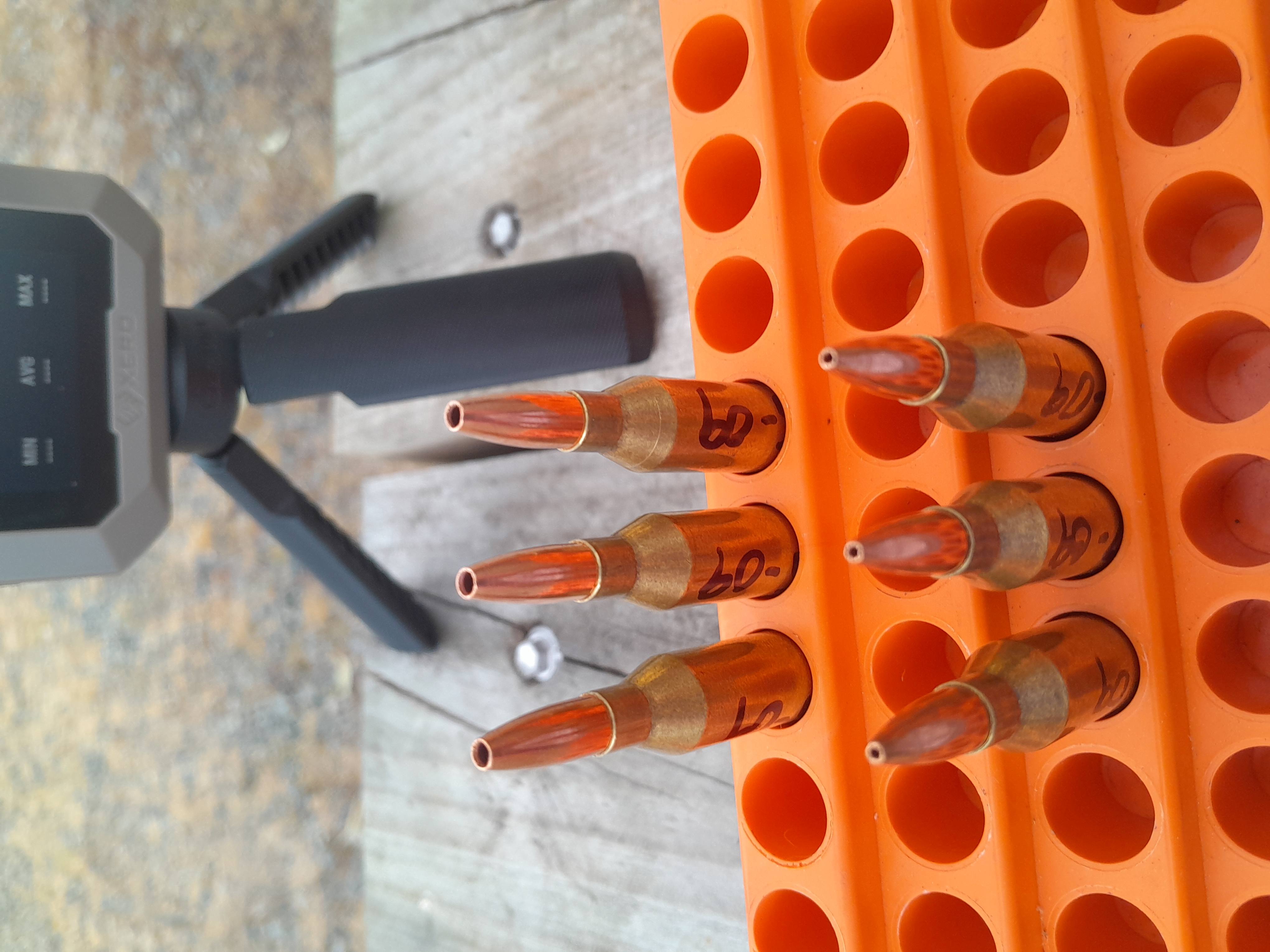

A look at what the projectiles look like, seated with one calibre diameter into the case, to get good bullet grip for mag feed when hunting.
These projectiles are too short to try and get close to the rifling, even though this particular Howa has quite a short throat when setting up 87-90gn bullets.
Big open tip is the 70gn Varmint, small hollow point is the 75gn TNT.

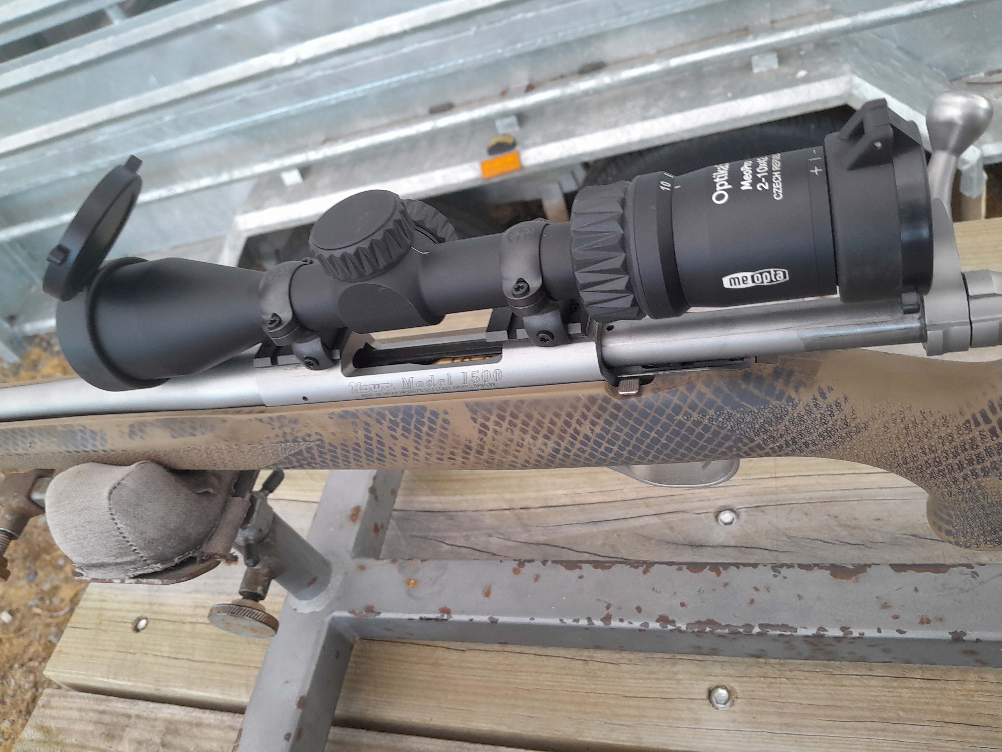

And the scope used. A Meopta Czech-made Optika 5, 2-10x42 with el-cheapo plastic ebay flip-up caps to keep the farm dust off.
For a mid $500 European scope (current price at The Barn while they last), this thing is amazingly bright and sharp as a tack, and on dark is as bright as daylight. And absolutely NO parallax detectable. Very impressed.

Take away from all this, is that if the first powder (or ammo brand) you try is unacceptable, you have to try something else.
Also that these projectiles are amazingly accurate with the right load, and super economical compared to others twice the price, even 3x.
And that some rifles are very fussy.
