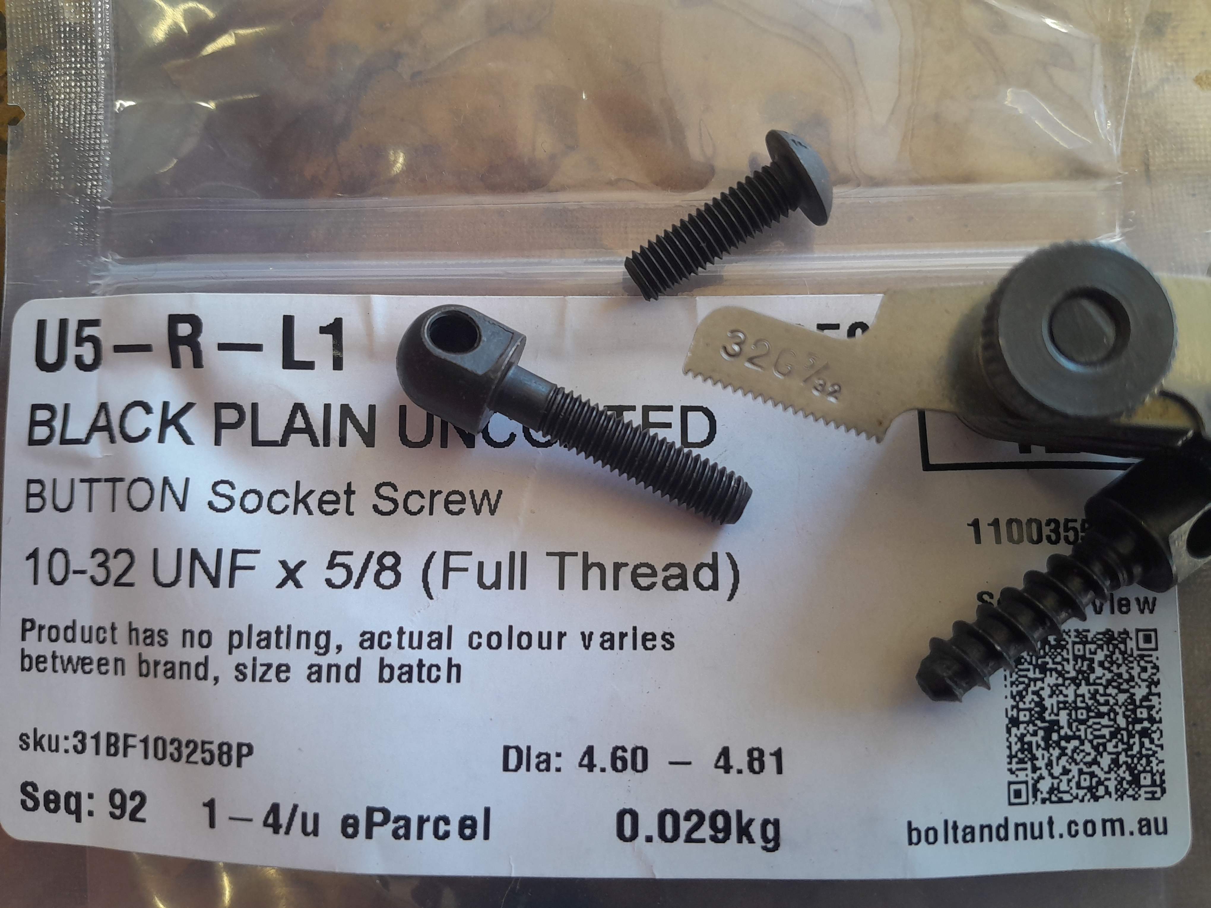

Just to prove if anyone wants to do this too, the thread is 10-32 as I said, I'll prove it with the pic here.
I can't physically hold the thread gauge in the swivel stud and get a pic with the other hand to focus with the phone, but here's the proof.
Machine thread standard for sling studs is 10-32, industry standard.
Dunno where 10-24 came from, but that's way incorrect.
10-32 it is.jpg (683.54 KiB) Viewed 896 times
I always try to prove what I post from doing, there's always someone who will have had bad info and will post it, not deliberately to prove someone wrong but only from believing others who do it. And of course there's someone always waiting to jump on you from accidentally getting it wrong eh, criticising is easy, making a post isn't.
That's not to say some obscure strange European firearm maker isn't playing with their own thread perversions, but I've not seen it.
The wood thread on the other hand, is 10 threads per inch, as measured reasonably closely, but you won't have options for that in machine screws so small and it's not what I'm suggesting either.

Just recently a friend asked me to extract the broken portion of the second front swivel stud on his Remington tactical composite stock.
I did so successfully although it did cost me a $30 solid carbide drill. I removed the front stud and found it was #10-24 thread so I cleaned up the cleared hole with a #10-24 tap. My friend supplied a replacement threaded stud which was fitted and all were fairly happy.
On reading your post I recalled I had an unopened Uncle Mikes stud set in a bits and pieces box which I found after some effort.
To my horror the machine threaded stud was #10-32.
So there, that's as much apology you are going to get.

Post by Wapiti » 02 Aug 2026, 5:37 pm
Nothing wrong with threaded aluminium with a hard steel screw in it.
No sling swivel QD stud in a Remington stock has ever been 10-24, sorry.
What you did was get the thread pitch wrong, tap the wrong thread, and therefore your opinion on steel screw in alum isn't a good one, because you forced the wrong thread into a hole tapped differently.
The fact he broke the stud off in the alum shows you how strong that union can be.
Drilling through such a small thread it's no wonder you got the pitch wrong, there's never much left after such a job and nobody alive gets a hole dead-centre in such a small hard fastener to use an easy-out.
