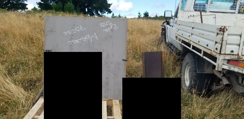

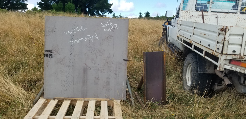

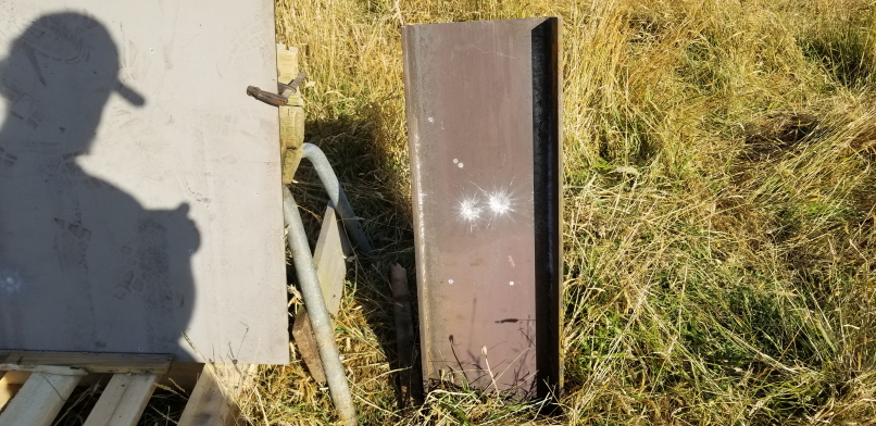

Then I drove the Landcruiser up as close as I could get to the target site but my mate decided the fence was very rusty anyway so he cut it and I drove right to the spot rather than try to move the 62kg 1200mm BZ450 square plate manually. We stood the plate up against an old firewood saw stool on top of the pallet they gave me with it, but the bottom 200mm was still hidden in the grass from the firing point. I also stood a section of 310UB next to the plate to see what the .303 does to the 6.1mm web at 500yd. This was also half hidden in the grass, a very, very small target at that distance - about 450mm tall by 300mm wide.

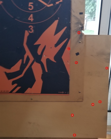

On the way back we set up the Figure 11 at about 300m, forgetting that I wanted it at 300yd - and checking it from the firing point it was actually 310m, 40yd over, oh well.
I started by confirming zero on the 125mm gong at 184m...actually it would've been around 190m today as I moved the ute further back to get 500yd on the steel plate - forgot about that. Wind was about six minutes there (I thought it was three-minutes as I had the scope wound down to 9-power as I wanted to try the Tactacam again but I put a new card in which it didn't like). Then I moved out to the 310m Figure 11 and held the reticle right along the left edge of the target. I forgot this was at 310m, not 300m - they all dropped into the bottom left corner of the target. We couldn't see .22-cal holes at 310m even with the 75-power spotting scope but we heard them hit the board so I figured we were in the right ballpark. Measuring them now they dropped about 500mm low and 450mm right of PoA, around 5MoA. I figured we were close enough to try for 500yd.

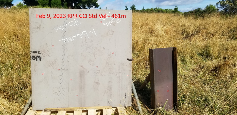

461m was a calculated 80 minutes up from 184m. I wound the zoom down to 4.5-power to quadruple the reticle subtensions, giving me 62MoA on top of the duplex post. I then dialled up another 20MoA on the turret to give me an 82MoA hold on the top of the duplex post. The wind had picked up so I held about 9MoA left wind on the large plate (about two-feet out from the left edge). My first shot smacked the U-Beam in the centre. We couldn't see splashes on the grey plate but we could see them on the mild steel beam so immediately saw how much wind there was - about 2m. A long way from where it should be but a very lucky hit that we could see - and I forgot to film the first shot. Without this hit I would've been shooting all around the plate trying to find it - we didn't see any ground feedback from any of my shots today but the closest shots I made were at 190m with the .22 and 310m with the SMLE. I fired about 30rds at the plate I think, with quite a few misses, but enough hits to go up for a look.
- 20230209_170935b.jpg (354.8 KiB) Viewed 6629 times
The plate has a lot of marks on it but we counted nine definite impacts on the plate and four on the beam. My wind holds were all around the plate so I can't conclude what sort of group might've been possible if I could've dropped more than a couple of consecutive hits on the plate, but the vertical spread was probably no more than a metre. Got some useful data so pretty happy with that.

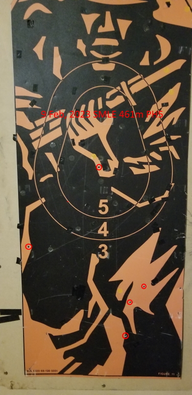

I fired five rounds with a central hold as I had raised the target and could now see its full height, but I couldn't make out any orange in it, it was just a tall thin dark patch a bit narrower than the front sight. Unfortunately the target was actually at 310m so would've needed another click with MkVII. My 2300fps Bertram's hit about 200mm to 300mm low. So my 300yd zero will be the 300yd mark plus one or two clicks. I might get better groups if I bullseye the target so my 300yd zero would be more like eight clicks past the 300yd mark - more practice will answer that (half the height of the 45" target is 7.5MoA at 300yd).

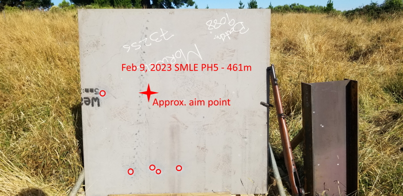

My measurements said that the 500yd mark should be about 12MoA up from a 200yd zero - the PH5 went 22 clicks to the 500yd mark so there is a big jump in there (as I discovered when I measured the sight). But I took a sight picture with the left side of the front sight lined up with the left edge of the plate to allow for any wind, and held halfway up the plate. I can't see the bottom 200mm due to grass so my hold was probably 500mm down from the top. I fired five and all hit, but we couldn't see any splashes on the grey steel, so we went for a look.
- 20230209_175543b.jpg (331.93 KiB) Viewed 6629 times
One shot went a little high, the other four were in a neat line across the bottom and 350mm wide. My elevation hold must've been amazing...but more likely a fluke
About 500mm low, or three minutes, so I brought it up to 25 minutes from 200yds. Again I think I might see better groups if I bullseye the 1200mm-square target that LERAA uses at 500yd so I might come up another four clicks and try it. Pretty happy with just ten rounds down range as I have some data to play with before further testing.
I still wanted to test the .303 against mild steel plate so I had a try at hitting the 6.1mm web of the beam. The target I could see was a tiny black dot about 400mm tall and 300mm wide. It looked like a spec of crud sitting on the front sight. But I took a dead centre hold along the line of grass at the bottom, and the bullet hit precisely where I aimed it. I hadn't hit record on my phone though so I thought I'd try again just to get video of it
Two more shots missed, though it looks like they buried themselves in the dirt two meters behind the target - I'll have to take the metal detector next time to see if we can recover them (they'd be around 1600fps here so it'd be interesting to see if they're damaged at all. I thought I'd try one more before calling it quits...and it hit right beside the first one.
https://www.youtube.com/watch?v=T5Rrp0Hpeh8The bullets left no visible or tactile damage to the mild steel at all, very nice to know. Higher-BC bullets will be hitting it with more velocity, and the smaller calibers will have even more speed and smaller surface area so I'll have to try those as well. But 6mm mild steel is a third of the price of this 5mm BZ450 and Bizalloy seems unnecessary past 500m or so. I'll move the beam closer until I see the first signs of damage, then turn it sideways to shoot the 10.2mm flange to see if they stand up any better.

From the shooting position, if I looked across the hill the four-foot-square plate was not at all obvious in the grass, if I didn't know it was there I doubt I'd have seen it. The steel beam beside it was equally impossible to see if I didn't know it was there. All in all a very fun afternoon.
The plan is to move the plate and the beam to another position where I can hit them with some other rifles out to 1000m, then cut it up into smaller close-range gongs. I'll use mild steel for long-range gongs. This LERAA shoot is next weekend so I think I'll just continue the .303 practice for now.
