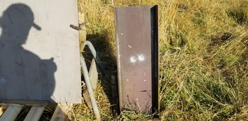

Got out again yesterday just to get some trajectory data. Spent some time plinking a 150mm gong at 182m first with the RPR to get a feel for the wind. It was swirling around but wasn't heavy, I didn't think it would effect the 174's at that distance in any measurable way.
I made a front sight adjustment the other night and dropped the sight back to the 100yd position, so I fired five rounds to check that. I'd moved the PoI from the right side to the left side of the board. At the 100yd sight position the shots are still about 150mm-200mm high at 200yd, I've ordered a taller sight in case I decide I need to correct it.
To my eyes at 200yd I'm seeing three horizontal stripes about a foot high across the board - black, orange, and black then the lower 200mm or so is hidden. I can see that the lower right corner is orange but the rest is in the grass. So I was aiming into the bottom black "stripe".
I also shot the bloody target frame again, I think that's six times now.
I drifted the sight back about halfway and fired another group. These went a little lower (it's far from a precise aim point) but closer to the centre. I gave the sight another tap and left it at that for now.
Then I switched to the modified SMLE to get an idea of its zero. You have to wind the PH5 sight up to the 800yd mark to remove the bolt - I really hope LERAA don't require bolt removal between strings, that would suck. I bore-sighted it roughly at a tree at 480m and the sights were hitting the hill around the 420m range. So I wound the sight down to the 400yd mark. I still expected the bullets to go very high at 200yd but they hit in the bottom black "stripe". Unfortunately, today I can't recall precisely where I aimed. After winding the PH5 down to 400yd I think I decided to aim at the same lower black "stripe" as they should've been on the board at least. Regardless, they're within a few inches so near enough to be going on with :-)

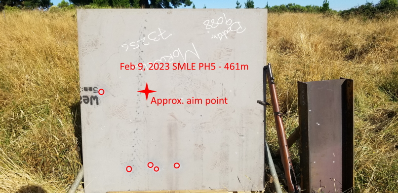

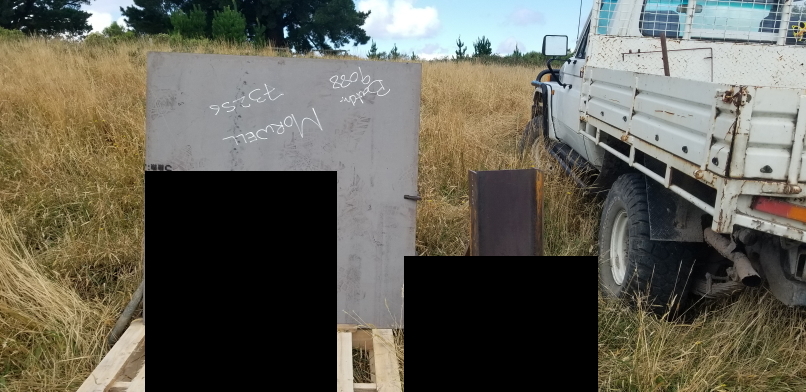

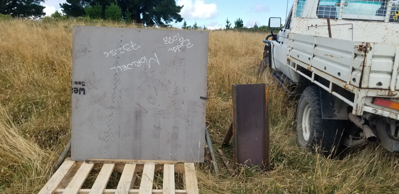

Post by bladeracer » 08 Feb 2023, 5:44 am
Went out yesterday to test out the camera on the RPR but decided to take the .303's with me.
I worked out that to see what the rifles are able to do, and to more precisely zero them I need a more precise aiming point than the big black-orange blob of the military targets. So I cut a square of A4 paper (210mm) and taped it as a diamond on a board. But the board I was using is full of holes already. I would normally take a before photo then go through all the holes on the computer later to see which were new, but my mate suggested just putting some newspaper on first - great idea - except that we couldn't see the holes from the firing position at 184m.
I wanted to zero the PH5 sight this time. The day before it was shooting about 100mm to the left but close to the correct elevation so I fired three rounds to confirm. We couldn't make out any holes with the 18power scope, so we walked up there and still couldn't see any holes at all...until my mate crouched down and saw light through one of them. The news print really hides them well :-)
I was impressed with a neat triangle 4.15" across about 100mm left of point of aim. I was holding 6 o'clock on the diamond as a centre hold hid too much of the white. I don't want a 6 o'clock zero though as I don't expect to be shooting at geometric shapes of fixed sizes.
I jumped online to try to find out what the PH5 sight adjustments are but got nowhere - it seems they can be quarter-, third-, or half-minute clicks? I needed two-minutes to the right so I tried eight clicks but didn't want them off the board so went back four clicks. If they're 1/4-clicks it'd be one-minute, if they're 1/2-clicks it'd be two-minutes, and if they're full clicks I should still be on the board. This time I tried a centre hold but could barely see any of the white above the front sight. These three gave me 5.17" slightly right of PoA and a little low due to the poor sight picture. I went back two clicks left and came up two clicks.
I fired a four-round group virtually on top of the first and 4.63" across. Very happy with that but still have no idea what the adjustments are so I'll have to measure those today if I get a chance. Four clicks right moved PoI about 150mm, but two clicks back moved it 150mm as well. I suspect they're half-minute clicks. But I'm close enough that a sighting shot or two should put me on target.

Post by in2anity » 08 Feb 2023, 6:49 am
Yeah that's not bad for a No1, and such a distance. You probably won't do a hell of a lot better in terms of bedding and load. Maybe do a stress test? Like 10 rounds in 40 seconds? (i.e. a rapid fire). Just to ensure that it doesn't behave strangely from heat.

Then I drove the Landcruiser up as close as I could get to the target site but my mate decided the fence was very rusty anyway so he cut it and I drove right to the spot rather than try to move the 62kg 1200mm BZ450 square plate manually. We stood the plate up against an old firewood saw stool on top of the pallet they gave me with it, but the bottom 200mm was still hidden in the grass from the firing point. I also stood a section of 310UB next to the plate to see what the .303 does to the 6.1mm web at 500yd. This was also half hidden in the grass, a very, very small target at that distance - about 450mm tall by 300mm wide.
On the way back we set up the Figure 11 at about 300m, forgetting that I wanted it at 300yd - and checking it from the firing point it was actually 310m, 40yd over, oh well.

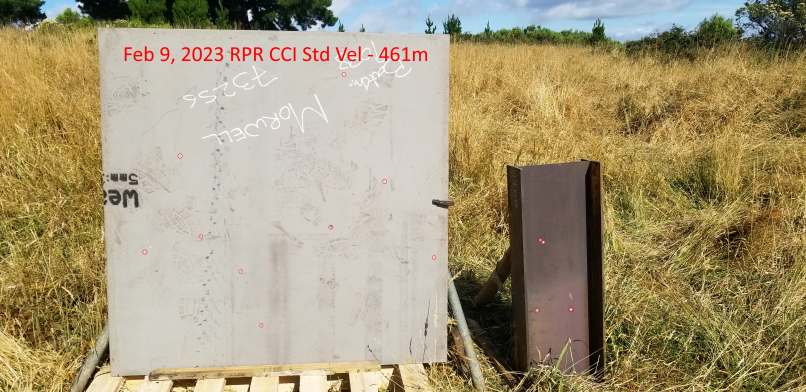

I started by confirming zero on the 125mm gong at 184m...actually it would've been around 190m today as I moved the ute further back to get 500yd on the steel plate - forgot about that. Wind was about six minutes there (I thought it was three-minutes as I had the scope wound down to 9-power as I wanted to try the Tactacam again but I put a new card in which it didn't like). Then I moved out to the 310m Figure 11 and held the reticle right along the left edge of the target. I forgot this was at 310m, not 300m - they all dropped into the bottom left corner of the target. We couldn't see .22-cal holes at 310m even with the 75-power spotting scope but we heard them hit the board so I figured we were in the right ballpark. Measuring them now they dropped about 500mm low and 450mm right of PoA, around 5MoA. I figured we were close enough to try for 500yd.
461m was a calculated 80 minutes up from 184m. I wound the zoom down to 4.5-power to quadruple the reticle subtensions, giving me 62MoA on top of the duplex post. I then dialled up another 20MoA on the turret to give me an 82MoA hold on the top of the duplex post. The wind had picked up so I held about 9MoA left wind on the large plate (about two-feet out from the left edge). My first shot smacked the U-Beam in the centre. We couldn't see splashes on the grey plate but we could see them on the mild steel beam so immediately saw how much wind there was - about 2m. A long way from where it should be but a very lucky hit that we could see - and I forgot to film the first shot. Without this hit I would've been shooting all around the plate trying to find it - we didn't see any ground feedback from any of my shots today but the closest shots I made were at 190m with the .22 and 310m with the SMLE. I fired about 30rds at the plate I think, with quite a few misses, but enough hits to go up for a look.
The plate has a lot of marks on it but we counted nine definite impacts on the plate and four on the beam. My wind holds were all around the plate so I can't conclude what sort of group might've been possible if I could've dropped more than a couple of consecutive hits on the plate, but the vertical spread was probably no more than a metre. Got some useful data so pretty happy with that.
Then I swapped to the SMLE. I have the PH5 pretty well zeroed at 200yds I think now, so I've adjusted the scale plate to suit. My measurements of the sight graduations on the original SMLE sight tell me that to move from 200yd to 300yd is about 5MoA drop (with what I assume is MkVII ammo). So I counted the clicks. Six clicks brings the scale to the 300yd mark, so are these one-minute or half-minute clicks. I needed seven clicks to zero from 200yd to 300yd with the Bertram, so most likely these are half-minute clicks. 3.5MoA drop from 200yd to 300yd would work for a bullet around .450-.500BC allowing for the lack of precision of groups over iron sights at these distances. Then from 200yd to 500yd we went up 25 clicks or 12.5MoA, which also fits a bullet of about .450-.500BC. So I think I've worked out a few things, but it still doesn't follow the trajectory of the original sight gradient under 300yd or so - they must've used a low hold at close ranges - though not with the PH5 competition sight.
I fired five rounds with a central hold as I had raised the target and could now see its full height, but I couldn't make out any orange in it, it was just a tall thin dark patch a bit narrower than the front sight. Unfortunately the target was actually at 310m so would've needed another click with MkVII. My 2300fps Bertram's hit about 200mm to 300mm low. So my 300yd zero will be the 300yd mark plus one or two clicks. I might get better groups if I bullseye the target so my 300yd zero would be more like eight clicks past the 300yd mark - more practice will answer that (half the height of the 45" target is 7.5MoA at 300yd).
My measurements said that the 500yd mark should be about 12MoA up from a 200yd zero - the PH5 went 22 clicks to the 500yd mark so there is a big jump in there (as I discovered when I measured the sight). But I took a sight picture with the left side of the front sight lined up with the left edge of the plate to allow for any wind, and held halfway up the plate. I can't see the bottom 200mm due to grass so my hold was probably 500mm down from the top. I fired five and all hit, but we couldn't see any splashes on the grey steel, so we went for a look.
One shot went a little high, the other four were in a neat line across the bottom and 350mm wide. My elevation hold must've been amazing...but more likely a fluke :-) About 500mm low, or three minutes, so I brought it up to 25 minutes from 200yds. Again I think I might see better groups if I bullseye the 1200mm-square target that LERAA uses at 500yd so I might come up another four clicks and try it. Pretty happy with just ten rounds down range as I have some data to play with before further testing.
I still wanted to test the .303 against mild steel plate so I had a try at hitting the 6.1mm web of the beam. The target I could see was a tiny black dot about 400mm tall and 300mm wide. It looked like a spec of crud sitting on the front sight. But I took a dead centre hold along the line of grass at the bottom, and the bullet hit precisely where I aimed it. I hadn't hit record on my phone though so I thought I'd try again just to get video of it :-) Two more shots missed, though it looks like they buried themselves in the dirt two meters behind the target - I'll have to take the metal detector next time to see if we can recover them (they'd be around 1600fps here so it'd be interesting to see if they're damaged at all. I thought I'd try one more before calling it quits...and it hit right beside the first one.
https://www.youtube.com/watch?v=T5Rrp0Hpeh8
The bullets left no visible or tactile damage to the mild steel at all, very nice to know. Higher-BC bullets will be hitting it with more velocity, and the smaller calibers will have even more speed and smaller surface area so I'll have to try those as well. But 6mm mild steel is a third of the price of this 5mm BZ450 and Bizalloy seems unnecessary past 500m or so. I'll move the beam closer until I see the first signs of damage, then turn it sideways to shoot the 10.2mm flange to see if they stand up any better.
